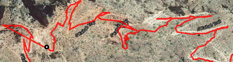

    There are these as well:
    These aren't perfect. Quite frankly they are messy and not a good representation of where I actually was. That being said, this is a wrist watch! I hiked the day before, and the day after without charging my watch! It's doing this by using signals from space! That's amazing! I've hiked enough with my watch to really trust it for navigation, but I understand it's not going to track perfectly 100% of the time. I'm at 74 hours of activities (you beat me) I've found it generally does a pretty good job in these cases:

    For another example of how bad it can be, here's what being surrounded by granite can do:
    I see folks complaining on these forums about terrible accuracy from their $1,000 smart watch. Folks buying these watches need to understand where the watch is going to perform well, and where it won't.
