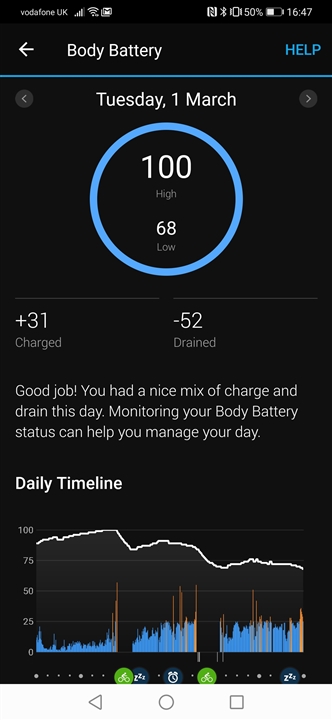

  • if sleep tracking is inaccurate then body battery will be too
    That's not true. Body Battery does not use sleep tracking metrics whatsoever. As proof of this, your sleep metrics are not calculated by the watch, they are calculated by Garmin's servers after you do a sync - yet, body battery is updated on your watch in realtime.
    It uses HRV stress. HRV stress happens to be low during sleep, which is why Body Battery recharges during sleep - but whether the watch thinks you're sleeping or not is irrelevant, because that does not change your HRV stress. So as long as the HRV stress metrics are accurate, then your Body Battery will be accurate, even if the sleep metrics are way off.

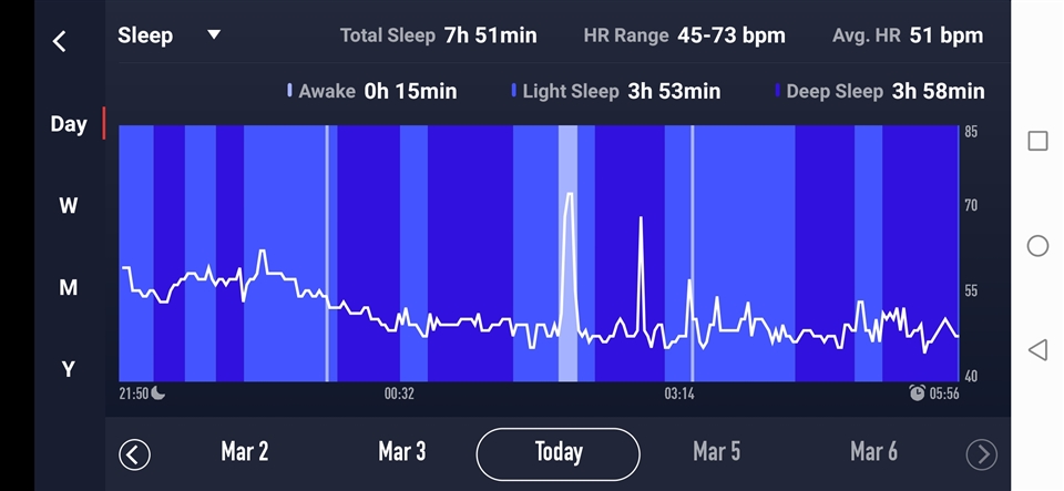

  • Same for me. But in my case I went to bet at 6am and woke up at 5 pm. The watch says I slept 8h31min when I actually had a 11h sleep. It says I woke up at 3:49 but I was in deep sleep then according to the graph. That would explain 1h missing. But where's the other 1.5h? Apparently 1.9h it says I was awake and substracts it too (even if I sleep like a log). And aprox 10-15 min are just lost on the way. Has anyone found a workaround for this?
