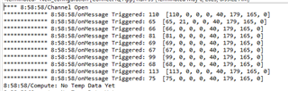

You know this stuff better than I do... but here is what I'm seeing.... every time I open the channel I get this sequence of pages from onMessage. Then I start to get pages 0 & 1 every second, and pages 80/81/82 only every 13 mins or so. I'm not sure where these are coming from or why, but these are not BROADCAST pages. So I can just ignore these. Anyway, that was where Page 75 was coming from... so nothing to see here :-)

Ant.MSG_CODE_EVENT_RX_FAIL_GO_TO_SEARCH == (payload[1] & 0xFF)
Yup I think the Tempe only transmits OK and Low - as I say I have seen watch messages saying the battery is low - but no more specific than that.
I don't know what the messages in your previous post are - a couple of them look like ANT file system messages, which is according to the spec how Tempe can receive current time. The message 0 values I see suggest it can receive UTC times, the display simulator doesn't send them by the look of it. The other thing that could be going on is messsages about the Tempe adjusting its transmission power once it's connected. I haven't found any documentation on how that's transmitted but I see these reports:
Device Sent Capabilities Info [this is probably just the message 0]
Device Changed Transmit Power
