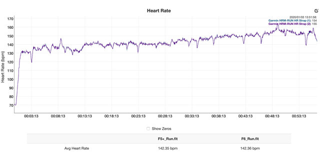

Today I went for a run with the F5 to see if the issue is the F6 HR accuracy after firmware 5.0, as I've ready plenty of people report this.
Sure enough, with the F5, my HR was back to normal - mid 140s instead of over 150.
This is all with the same HR strap. That's pretty annoying if I logged 4 weeks of crap data. I'm going to stay with the F5 until I read about something changing with the F5 HR. Makes it a waste of money for now.
