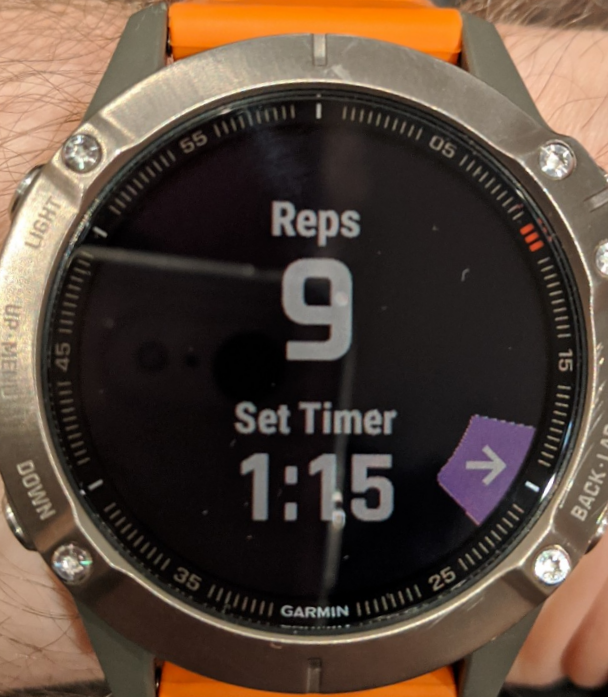

  • Former Member
    0 Former Member over 5 years ago in reply to Crispin_Ellisdon
    See pics -- this is the main bug I'm referring to.  Set screen flipped to black for one set out of ~30.
    Normal:
    And then once in a while the random inversion:
