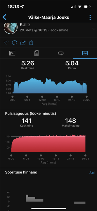

  • Former Member
    0 Former Member over 3 years ago
    Big difference
      Fenix 6x to Polar Beat
    Garmin Hrm pro belt
    Polar H-10 belt
