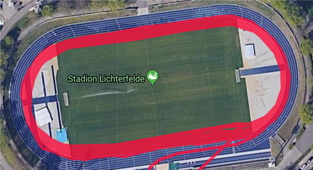

  • Here is another example what I meant with
    track is most of the time about 20m off to the left
    I was running counter-clockwise about 20 laps on the inner most lane. The recorded track is off to the left (fenix 6 Sapphire, Firmware 4.65 Beta, GPS 2.60, GPS/GALILEO, smart recording ).
    On all my workouts with the Fenix  it is always to the left, never to right (in direction of movement). I wonder if it is because I wear it on my left wrist Thinking. I have to try it on my right wrist the next time.
    I must admit this is not critical to me, but I think the Fenix 6 can/should be more accurate.
  • That's a very clean reocrding though ! But how reliable is the distance ?
  • Hello
    Same here.
    I switched from left arm to right arm while running this morning and the track is much in the center (even if I usually run on the right side of the road).
    There is something strange here... But for rest of the track, it is quite a clean recording.
    Benoit
