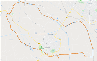

  • I ran with my girlfriend this weekend (25.23Km in 2 hours), she has a garmin 935 (blue line), the orange line is mine, a garmin fenix 6X Solar, firmware 6.10 GPS+GLONASS, recording every second.
    In mine opinion the GPS is pretty accurate. For accurate pace I use a stryd footpod.
  • Looks very similar, looks also like a flat course with mostly open view to the sky. I think it is not the point of this discussion that the 6 delivers good tracking under good conditions and also for faster activities like cycling.
    If you want to see differences between watches, you might run in hilly and dense woods and without a Stryd to be able to compare the distances. Wink  An expensive watch like the F6 also has to deliver good results under tough conditions.
