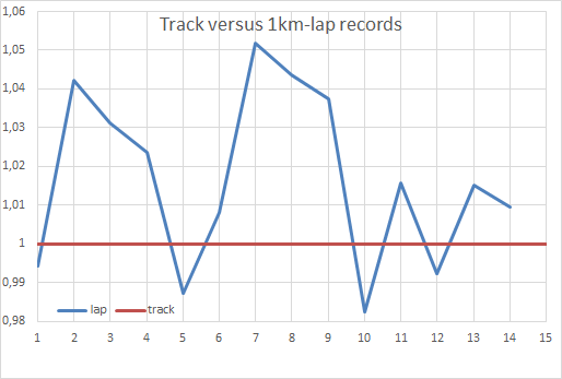

    Comparing the tracks they do not differ that much, but Garmin is not able to program correctly. The displayed distance on the device is different from the distance you get calculating out of the recorded track. The 1km-lap very often is shown later (means you ran more). Unfortunately this means that the performance displayed is incorrect. My yesterday's run had again severe deviations between the "real" 1km (calculating out of the track which is very close to the data from the track recorded from the V800) and the 1km out of 1km-laps shown while running (as also shown in the csv-file you can download).
    I deleted the data which is at the end of the run (fenix 6x pro ended up with 14,81 km, the track data result is 15,20)
    recording lat/lon-values with accuracy of "xx.1028657816350460052490234375" (copied out of the gpx-file and removing of the digits at the beginning)is absolutely useless. calculating the distance is very simple and I think that Eratosthenes (200 bc) would have done it better than Garmin.
    data was recorded in 1s-intervals, GPS+Galileo.

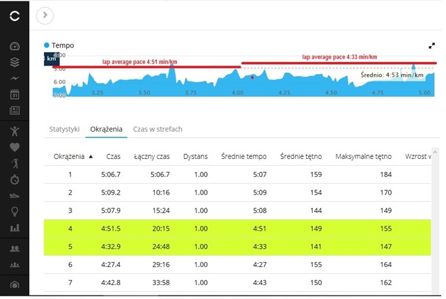

    Can anyone please explain to me how it is possible to get such average results based on pace readings shown at graph ?
