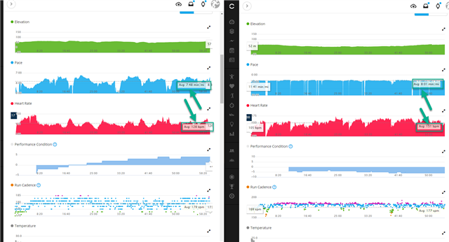

  • So I tried power cycling (turn off/turn on) last night before I ran and then tightened (slightly uncomfortable, but not ridiculously tight) the watch after about a mile (and my heart rate fell back to something a bit more normal), and the run on the left below, seemed to have a heart rate somewhere around normal (125 ish). I was quite happy with this, as it was either a power on/off and/or a tightening of the strap (although it was tighter than I would like to wear it).
    This morning (right hand run), I ran again, with the watch tight, but with no power on/off and annoyingly, despite a slower pace, my heart rate was up to the 150+ mark i.e. too high again...
    Conclusions at the moment are some kind of software bug that necessitates a restart/power on/off of the watch to ensure the HR isn't reading high, combined with very tight watch strap...

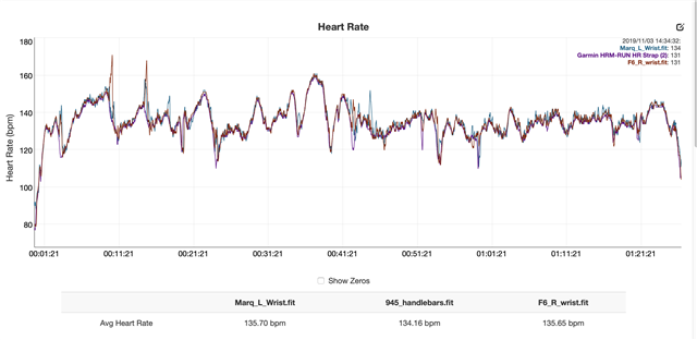

  • I don't know what Garmin have done, but this is by far and away the best result I've ever had from WHR when cycling. My scepticism about the utility of WHR is diminishing almost daily. I am hoping for consistency because too often, the next time out the WHR has been hopeless.
    Just in case you don't check the legend in the top right, F6 and Marq on WHR on the wrist, 945 on the handlebars on old version HRM-Run
