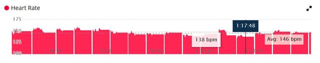

I purchased a third party HRM and it keeps disconnecting every 5min (with ANT or BLE). Garmin support claim that it comes from the third party sensor and not the watch...
However I have a similar issue when I connect my phone (android) to the watch, the bluetooth disconnect after 5min. I either have to wait for a few minutes or restart the watch to have the watch connected again.

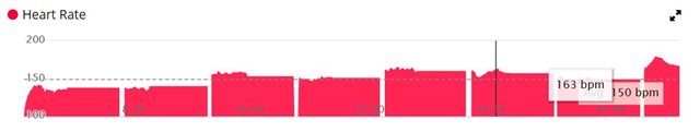

    I know that the HRM disconnects because the HR either comes flat or just indicate "--". Then the message "external HR connected appear" and correct data reappears.

    However, now that I see the chart I'm wondering if the battery in the HRM is bad.
