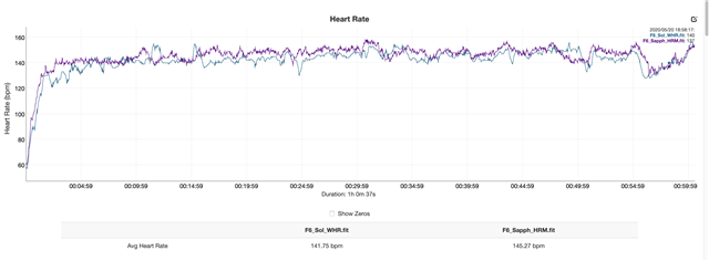

  • A run with two F6s last evening. It's a lot better than some folk get but the difference is why I always wear a chest strap for 'active' activities as Garmin recommend.
