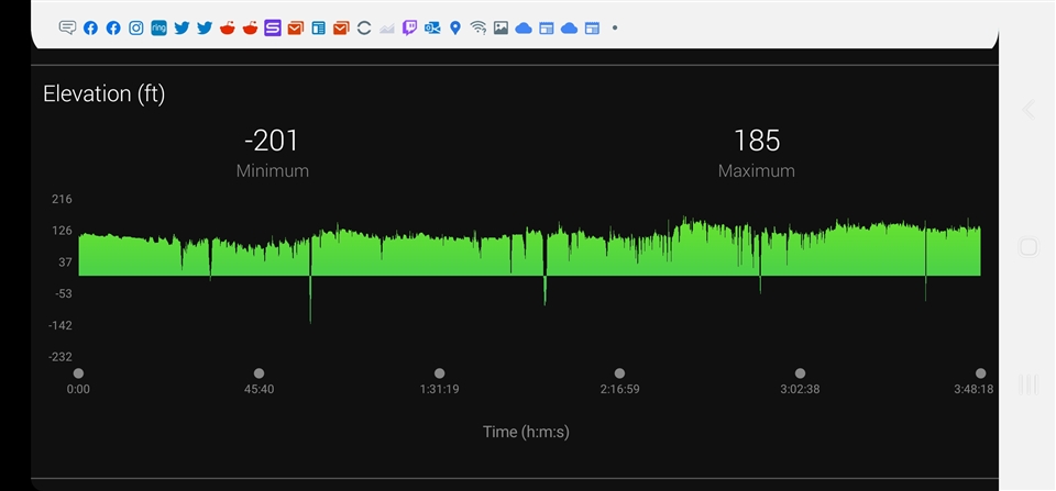

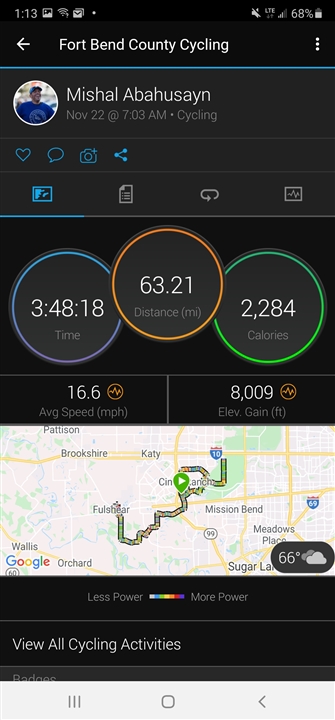

    I live in a flat part of the country (houston TX) i went for a 63 mile ride today with the fenix 6 pro for the first time today and was surprised that i had set a new elevation gain record. 8000'. The elevation is about right but very erratic. Very frustrating.
  • You had several weird drops to zero and below zero altitude which will obviously give you several incorrect gains when corrected.  The question is what caused those drops on a fairly flat course.
  • The barometric altimeter in the F6 should only be used as a very rough guide as to your altitude change. There are so many factors that go into making an accurate calculation of your altitude over time that it is no wonder you can get strange answers.
