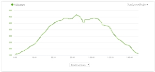

  • The choppy alttitude problem which inrtoduced with V4.10 exist with also at V4.11 beta. Fenix 6X pro.
    During a trail run activity altitude reading is changing very slowly. I was at a steep climb  and I was watching the altitude reading, and from 410m, froze at that value for 3 to 4 minutes (while I was climbing), and suddenly went to 430m, froze for another 2 minutes, then went to 455m, etc.
    As result the altitude graph is very choppy, and the total elevation gain was wildly underestimated.
    Settings were GPS+GALLILEO, Recording every 1 sec, maps on, Auto cal --> During activity ON, on start ON, Not during activity ON. Start altitude was correct.
