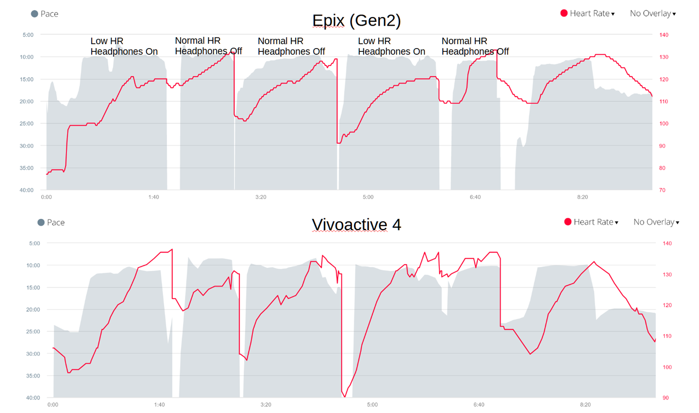

I have had issue with low heart rate at beginning of the activity.  It started intermittently with Software v15.77.  It got worse with v16.22.  I did testing before and was able to replicate and resolve the issue, by toggling the headphones on/off.  Another fix is to pause activity, reboot device, and resume activity.  These are just temporary fixes.
I just updated to v17.23 this week.  My first 2 runs had normal HR.  I thought maybe Garmin fixed the issue, or the update reset some setting that resolved the issue.  Unfortunately, that was short lived.  Issue returned on my 3rd run.  So I did headphone toggling test again.  No surprise.  Same result.
Here is comparison between Epix on top graph versus Vivoactive 4 at bottom graph, for the identical run.  By toggling the headphone status between on and off, I can cause Epix to have low HR reading.

    I have done close to 50 tests over past 2 months.  And I'm wearing 2 different Garmin watches at same time to compare.  External conditions are not factor (or cause) in my case.
    I have done soft reset and hard reset.  Soft reset does nothing.  Hard reset means wiping the device completely and going to default settings.  Yes, hard reset fixed the problem immediately.  Then I proceed with step by step setup.  That is when I found out my issue occurs when headphones are paired/connected.

  • Update.  There is some other setting conflict combined with headphone (bluetooth) causing this on my watch.  And v17.23 is "better" than v16.22 in occurrence rate.
    On v15.77, I had around 8 occurrences of low HR in over 60 runs. The occurrence rate is quite low.  Just looking back at the data.  It was hard to detect, and depends on my pace and actual HR, because I didn't use another watch to compare.
    On v16.22, the occurrence is around 90% of time when using headphones.  And I'm quite certain on this, as I was comparing Epix Gen 2 with Vivoactive 4.  After I noticed the headphone dependence, I stopped using headphones for 1 months, and had zero issue.
    On v17.23, I resumed using headphones to test it out.  First 2 runs were fine; then 3 runs with issue (confirmed headphone dependence by toggling headphones on/off); now 2 most recent runs are fine.  The only thing I did recently was I used a built in watch face for a day, and then went back to same 3rd party watch face I have been using.

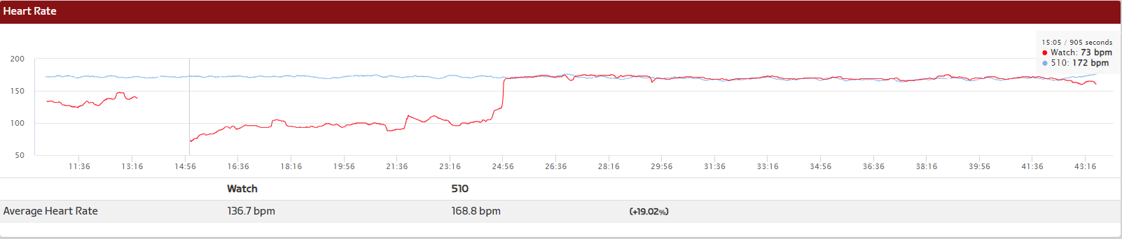

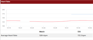

  • Did a 1/8 Triatlon yesterday and during the cycling I had both my watch (wrist sensor) and Edge 510 (coupled to my chest strap). Since the swim + transition should be more than enough of a warm-up, I was surprised my Epix Gen 2 was still struggling, until minute 25 (or about 13 of cycling), after that it was almost spot on again. Around the transition it had a dip again, during the Run it seemed all fine, (reached even my max heart rate), but have no dual recording of that part.
    Watch vs Chest strap
    Most interesting part is the transition. My phone was in my bag next to my bag and it seems my heartrate of my Epix Gen 2 goes down from 150 to 130 the moment that I arrive at my bike, where you can see that my heartrate measured by the sstrap is much higher when I start cycling. It seems that Bluetooth connection influences the heart rate measured by the watch and even worse, that it takes about 10 minutes after loosing connection before the "correct" heart rate is measured by the watch.

    Good work.  In both yours and my cases, there seems to be bluetooth dependence.
    Please share this data and finding with Garmin support.  When I contact Garmin support, they just treat this as one off.  They search their knowledge database for headphone conflict with HR.  It seems to be higher level issue with bluetooth.
