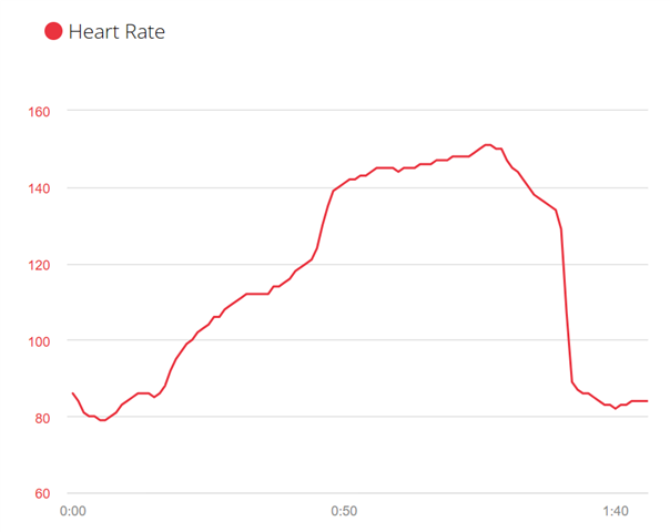

My Epix 2 has been behaving unusually since the last update. It’s used to track heart rate smoothly but now seems to get stuck at low values for a long time and suddenly jump to what “feels” like an accurate value. See screenshot for one example.

Hello LLang
I am sorry to hear you are seeing an inaccurate HR during the indoor row activities. It is common to see HR become inconsistent during some activity types. This could include, but is not limited to Rowing, cross fit, weight training, tennis, cycling, skiing etc. The reason for this, is the optical HR sensor requires the blood flow passing freely to the most surface layers on the back of your wrist. This types of activities include heavy wrist motion and/or gripping of handlebars. This can push the blood flow away from the outer layers of your wrist, preventing the watch from picking the HR up.
Because this is a physiological effect, the extent to which each person experiences this effect can vary.
You can try to mitigate this by adjusting how your wear the watch. You can adjust this to be further up your wrist. You want it to be snug, but not to tight. Some have luck with switching wrists, or wearing the watch on the inside of their wrist. You may also try a warm up before the workout.
However, if none of these help, we would recommend using an HRM chest strap instead. As this would not be impacted by the motion or position of your wrist.
Thanks Laurie,
appreciate the response again. I recognise an inconsistent reading like this is more often associated with activities like rowing. However, the issue is new. I had never seen it before update 16.22 and has remained a consistent issue since then. The before/after comparison is quite clear, I've go loads of data.
I recognise your advice is the accepted Garmin response. The evidence is there that this only happens since 16.2. Further, I don't see why a solution for a software issue would should entail me spending more money, on more Garmin products, to address a BUG that has suddenly appeared. If the EPIX doesn't function as before because of a software update then sending me an HRM free of charge would be an responable place to meet in the middle.
Cheers,

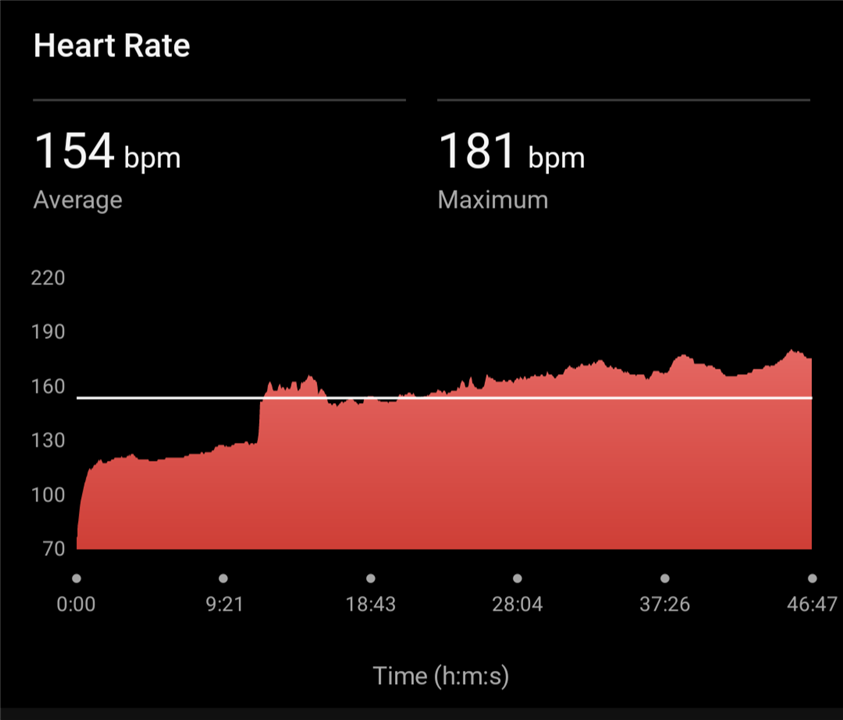

I have the same problem with my epic 2. Same symptoms. I have tried positioning it differently(up the wrist) and using the pro heart rate strap. The problem persists. Also have to mention that it is intermittent. Malfunctions about 30%of the time
