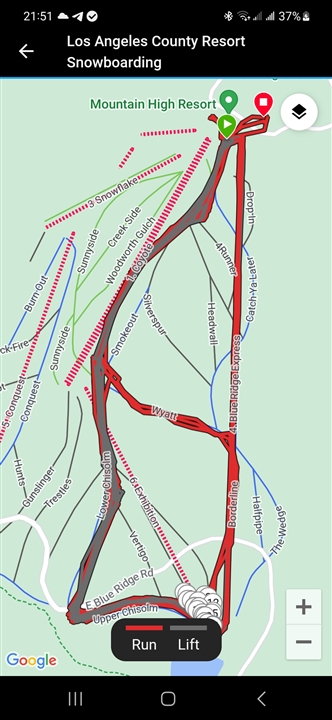

Later, when viewing the activity on the Connect app, the new Run/Lift highlights on the map are completely bogus, some (portions of) runs are highlighted as lifts and viceversa.

  • Same issue with Fenix 7 Pro. Not only are the lifts and runs totally messed up or tracking doesn't work at all (which is an apparent bug) but another annoying "improvement" of the 15.74 upgrade is that the lifts are now included in the distance. I've been tracking skiing for a very long time and also track equipment which is now inconsistent with the history. Regardless, can anybody from Garmin explain why the *** shall the lift distance be included in the activity? Sitting on a chairlift or in a cabin, what an activity.. I hope this is also a bug and not a feature and both will be fixed soon.

    My runs are lifts. My lifts are runs.
    connect.garmin.com/.../13057496664
