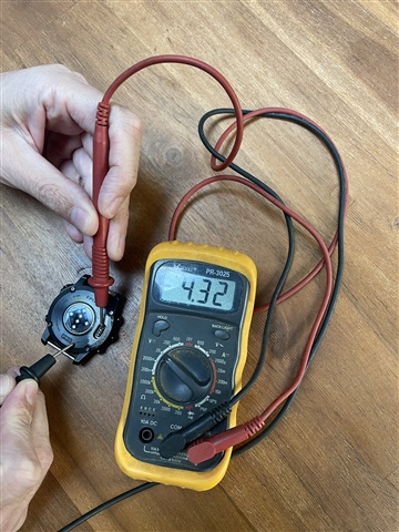

This watch charging pins are burning very painful holes in my skin and they leave quite bad scars, very similar to a burn or chemical burn wound.
There is also excessive corrosion around the charge ports. (keep in mind that this watch is 2 weeks old!)

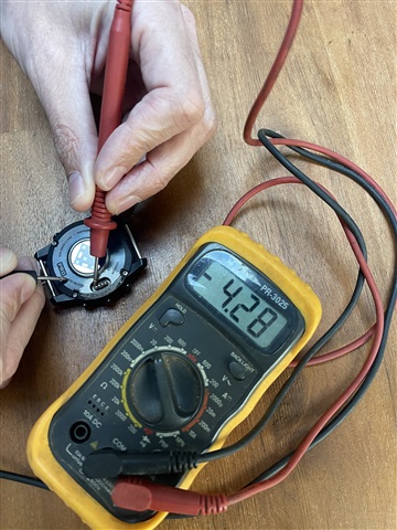

Today I got my hands on a multimeter and found that there 4.3 volts on the two outer pins, and this conducts/grounds to the watch body.
Has anyone seen this before? I measured the voltage on the charging pins of my old quatix 5 and there is no voltage. I had to stop wearing the new Epix as I now have multiple scars and wounds on my wrist.
As I purchased this watch at an airport in another country I am not sure if Garmin will help me locally. Could this be a software bug that can be fixed with an update?
Thanks,
  • That looks like galvanic corrosion, which is pretty strange for the back of a watch. However, that watch case sure looks like it's an anode, and if there was a potential difference between the charging port and the watch case, which it looks like there is, and you are immersing the whole thing in a moist environment (i.e. a sweaty wrist), those would be the ideal conditions for galvanic corrosion.
    If I had to guess, I would say you might have something with a positive charge inside the watch that is touching the watch back and creating a potential difference between the watch back and the charging port. If that's what it is, that would obviously be a hardware problem.
