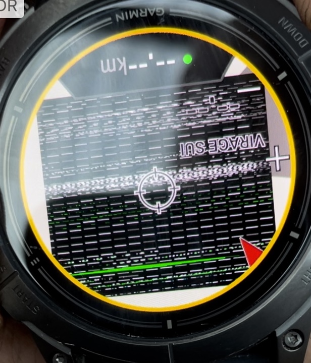

I've had this happen twice, and each time only a restart fixed it. In all screens where a map is shown (outdoor workout, weather widget with RADAR, sunrise/sunset widget screen that shows sun arc) the map gets corrupted. Anyone else seen this?

I also got this view of corrupted maps in all the activities I'm doing (bike, run, hike)
Same thing happened to me. Resarted epix pro 51mm and it is working again
I still get corrupt map graphics from time to time too. Epix Gen 2 Pro on 14.36 firmware with all maps updated. A reboot or soft reset fixes it for awhile, but then they come back.
I am sorry you have the issue. I have been unsuccessful getting examples of the issue and I will need customers willing to work with me so I can have our engineering team track down the issue to resolve it.

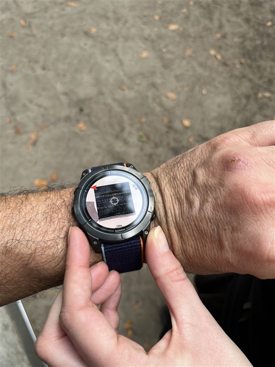

Thank you for your example. I am sending you a Private Message. When you are signed-in to the forums, check the top right corner to the right of the Notifications lightning bolt icon.
yes I’ll be glad to help. I’ll reply to your PM.

I am in this same situation as well. Just received a newly purchased 51mm epix pro gen 2. Updated to the latest software version and latest topo maps and experiencing the same corrupt maps issue.
I only displayed the corrupted map once.
I shut down and restarted and it didn't do it again.
I also use 5 KMZ custommaps, along with OSM and Topoactive
It is important that the maps are not selected all together! But maximum 2, one raster and one vectorial.
