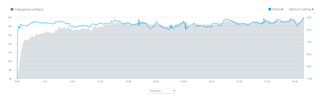

Question: The relatively correct pulse is displayed up to the 18th minute. From then on, despite the same effort (same incline, relatively same speed), I received heart rate data in the 115 range for over 23 minutes, although the 160 range would be correct? This deviation is extreme and I can no longer do anything with this data!
From the 40th minute onwards, my heart rate is back in the realistic range.

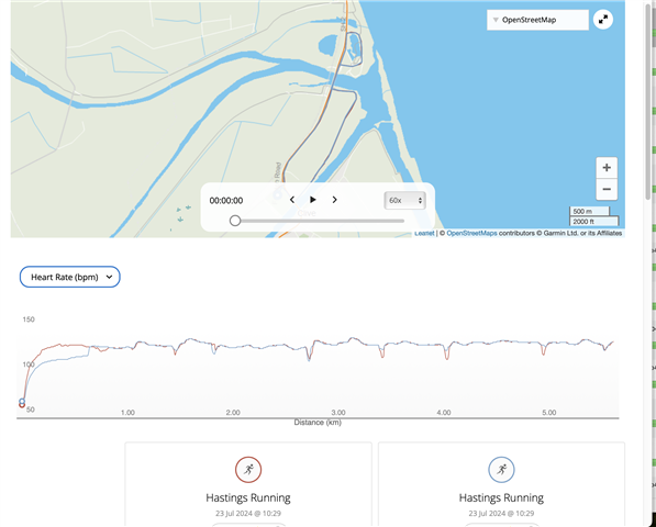

Following another Plot (Training) with similar problem.
Beforehand: Yes

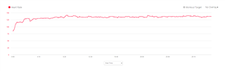

    On my garmin epix 2, the heart rate jumps rapidly from 120 to 150 or even 160 bpm in a second after several minutes of training.
    During the last few training sessions the heart rate did not rise above 125 bpm, while comparing it with other heart rate monitors and it should be around 155. I wear the watch correctly and in the past I did not have this kind of problem.
