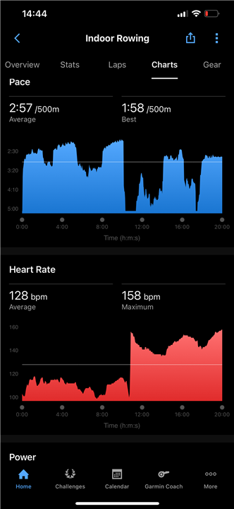

  • From this graph it seams to be the same issue. It seams to read the movements in heart rate but then jumps by a factor of about 20-30! Don’t know why. But it does not seem like a sensor problem but rather a software issue.
  • The heart rate only jumped when I stopped. I had to stop as I blew up trying to get into my heart rate zone. I was already way past my target zone. From the point of the break heart rate seems accurate but I had already ruined my training.
