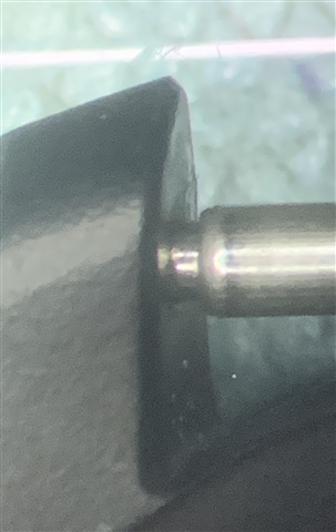

Just to add a bit more detail on the measurements of the pins/spring bars using a caliper.
The Fenix 6 Pro original pins
Pin diameter - 2.28-2.29mm
Pin diameter at the end - 1.60mm
Hole on the Fenix 6 Pro - approximately 1.65mm - (It was difficult to wedge it into the hole to get an exact measurement)
A very slight play on the pin inside the watch hole, but it could be coming from the cylinder and the ears of the pins.

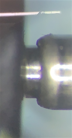

epix 2 original pin
Pin diameter - 2.28-2.3mm
Pin diameter at the end - (this is also approximate as it was difficult to get an exact measurement) - ~2.09-2.10mm
Slightly more play comparing the Fenix 6 Pro pins inside Fenix 6 Pro.

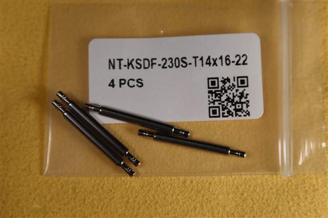

Well... the "generic fenix 6 spring bars" from Strapcode arrived today:
The 1.6mm tips appear to be appropriate for the epix Gen 2, and I have confirmed the 2.3mm barrel on the springbars works smoothly with Garmin QuickFit straps/bracelets.
All that remains is for me to work up the courage to destroy the stock installed epix springbars and fit these replacements - working on my mental focus as I type...

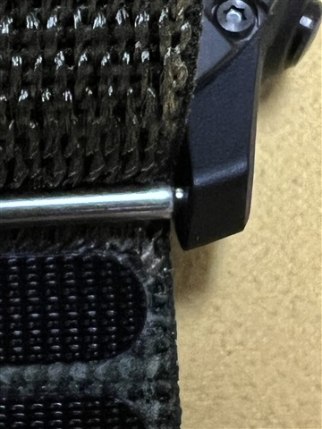

Yes but it requires a tool for the purpose or you may try with something thin but stiff that fits between the outer and inner part just by the end on one side.
I'm sorry, but I don't see any way to use a tool for this with the original spring bars. The spring bars used by Garmin do not have grooves for this.
With these Garmin standard built-in bars you have no possibility to use a tool, because there are no notches where the tool can be used.
Of course, there are workarounds to loosen these pins. But they are not intended to be removed by the user.
