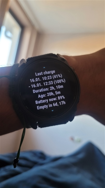

  • I have the issue started to reproduce after using PulseOx for a couple of night. After disabling it my baterry drain even increased... Was charged yesterday noon and before sleep there was 93% last(durind the day: one activity - 40min jumprope and update to 13.18). Today mornig was 89% so 4 pure percents in night mode without PulseOx!
    I tried hard reset couple of times last days but not helped.
    I use stock watchface. Before, I have drain about 5-6 %/d what is also more than from the start using E3(<4%)
