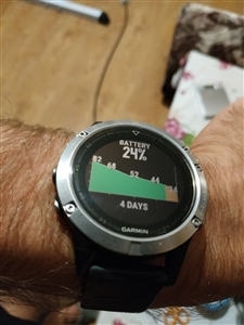

I updated my garmin fenix 5 with 14.10. I still have problems with high battery consumption.
Consume 1% per hour. With software 13.1 I had consumption of 5% per day. I tried to reinstall 13.1 but now it continues to consume a lot, always 24% a day. What can I do?

  • With v14.1 i got high battery drain. I put v13.30 with upgrade to v13.51 beta. I used him 2 weeks and battery was fine 0.2-0.5% per hr. But today i got high battery drain, after use watch with walk activity. I try to stop/start sensor, acticity tracker, watchfaces and shutdown but not help. After 3-4 hours problem dissapear alone.
    4 days battery hiostory
     1d - 14% - 13200 steps, cycling 38 minutes (gps off) (sensor on)
    2d - 16% - 1550 steps, no activity (gps off)
    3d - 8% - 2800steps, 55min strength activity (gps off) with ant+ chest strap
    4d - 20% - 15000 steps, 50min walk activity (gpsoff) (sensor on)
    This is with v13.51beta
