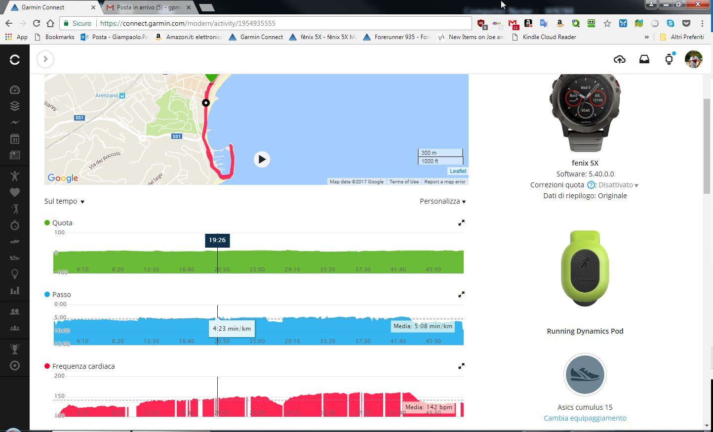

    This is the typical behaviour I got with my 5X and Polar H10 (see picture, red chart is the HR readout from Polar H10 with several dropouts).
    That's why I moved to FR935 for my workouts without any single dropouts with my Polar H10.
    ciq.forums.garmin.com/.../1252610.jpg

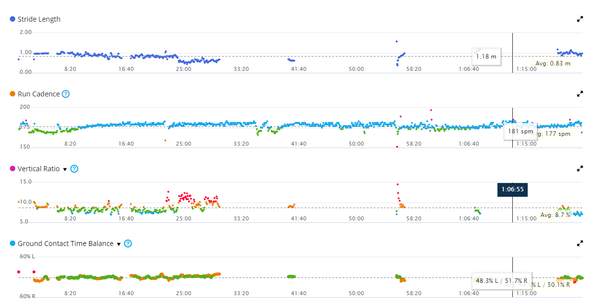

  • Hi Guys,
    have a two week "old" Fenix 5. Had varying success with the HRM TRI GCT transmission, but today's run is beyond tolerable. Not this was still 5.83B, before 6 installed. I would say that there is some drop-in instead of drop-outs (https://connect.garmin.com/modern/activity/1991307493)
    Tamasciq.forums.garmin.com/.../1254176.png
