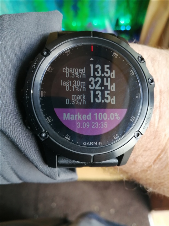

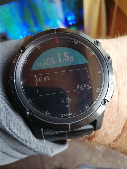

    Also I have put on a new watchface called InFocal recently - I am still keeping a log of power drain after 5.04 downgrade for feedback to Garman and InFocal does not seem to use any more power than the built in watch faces, just 2% overnight typically. So if you like 3rd party watchfaces, Infocal seems safe.
