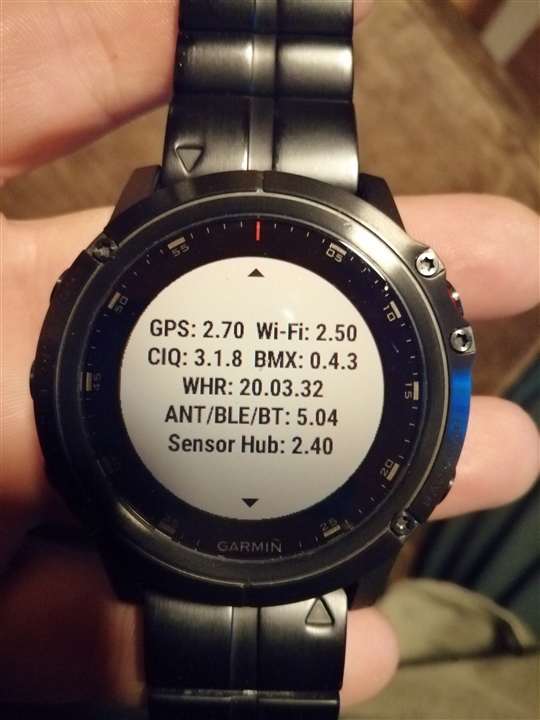

  • I've taken off software version 13.00 and 6.06......and replaced with 12.00 and 5.04.....no problem with the installation on my 5x plus, the watch prompted me to install the moment it was unplugged... I used a link here in this thread for the ANT....I'll see over the next day if it's worked for me...
    I'd also like to thank the users/posters here for the information that was shared, I appreciate it. : -)
    Is this the right setup in the pic?...is the GPS version right?...
