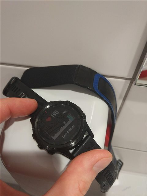

  • It is still happening (it just happened) on 7.60.
    To me, the issue is coming from the HRM strap. It is detecting some sort of signal (who knows from where, as I was even drying the contacts, but this didn't change anything), and sending it out. I used a Polar H7 HR sensor before, and I don't recall I had this issue... maybe I'll re-test it.
    It is quite annoying as I wanted to see how my hear rate was after the run, but of course I take off the HRM before I go to the shower and I will not put it back afterwards, just because it thinks that it is still measuring something.
    Below a picture:
