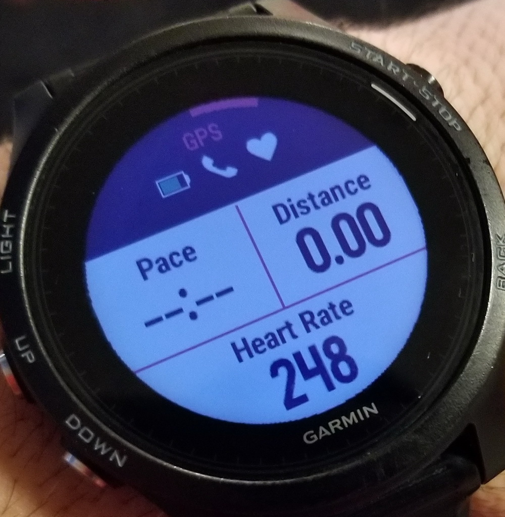

I can't be the only one experiencing this? (and I didn't see anything in a quick search). After indoor cycling, my HR figure will sometimes soar out of control almost like I'm having some sort of afib episode (needless to say, it freaked me out the first couple of times I noticed it).
Here's the scenario: I finish the activity, save it in the watch, then remove HRM-Tri and put it in my bag. For some reason (such as when this photo was taken -- I had opened the run mode to see if I could trick it back into normal), the OHR (wrist HR) stays off/unlit while the HR figure (presumably from the HRM-Tri (chest HR) sitting in the bag) soars out of control.
Please tell me there's some easy solution? I've tried removing the HRM-Tri _before_ saving/closing the activity, after (such as this evening when I snapped this image) and nothing seems to work. Maybe if I go into Sensors & Accessories and manually disconnect the HRM-Tri each time?

  • Yeah, I have a similar issue with washing the hrm-run after an activity. If the watch is still in range (if I haven’t taken it off) then I get ridiculously high numbers. I have started disabling the hrm-run from the sensors menu after each activity, but the problem is sometimes I forget to re-enable it. Not sure if anything can be done about this, unless Garmin decides to disable the connection to the external hr strap while not in an activity. (Maybe that could be an option: on/off/on during activity).
    I also could’ve sworn that the hrm-run only works while you’re moving (which might explain your issue if you pick up your bag and walk around), but I guess it takes a while to time out and go to sleep.
  • The chest belt should shut itself down after 2 minutes of being motionless, at which point the wrist OHR should come back on. Picking up your bag and moving within those 2 minutes may keep it awake. Checking the status on the watch will actually keep the connection open - if you want to know what is happenning, check the LEDs on the back of the watch. If they are on, the strap has turned itself off.

    Yes it is a common problem with the watch connecting to a Tri or Swim strap after the activity has been saved. You can confirm it is connected under the system/settings/sensors and accessories then look at the status for a particular strap that the watch has previously connected to.
    The watch is always searching for a known strap if not already connected. When connected to a strap that is not worn (in your gym bag for example) you can get a rubbish signal and merrily watch your HR climb to 250 using the HR widget. I don't know about a 2 minute timeout on the strap as mentioned above. It seems a lot longer, maybe prolonged by the HR widget. FRUSTRATING!!!!

    The OP is not saying the HR is detected after exiting an activity. He's saying an HR is detected from the strap when the strap is not being worn and an activity selected. That's what the image is showing.

    -- the image was snapped in run mode only to see if I could trick it somehow. The spiked HR happens regardless (e.g. clicking the down arrow while on the clock).
    -- The HRM-Tri strap is indeed wet in the bag. I rinse it after the activity because spin is always a disgusting sweatfest.
    -- I do always wait 2 minutes before saving the activity to check the HR prompt -- that isn't the issue here.
    This could indeed be fixed with an option to disconnect any external HRM upon saving the activity.
    And for those asking what the issue is here: I actually like having my data correct in GC. And, even if I know what's going on now when this issue is happening, I still take a manual pulse just to be sure. It's like trying to ignore some fire alarm when someday it could actually be the real thing. I don't care for it at all.
