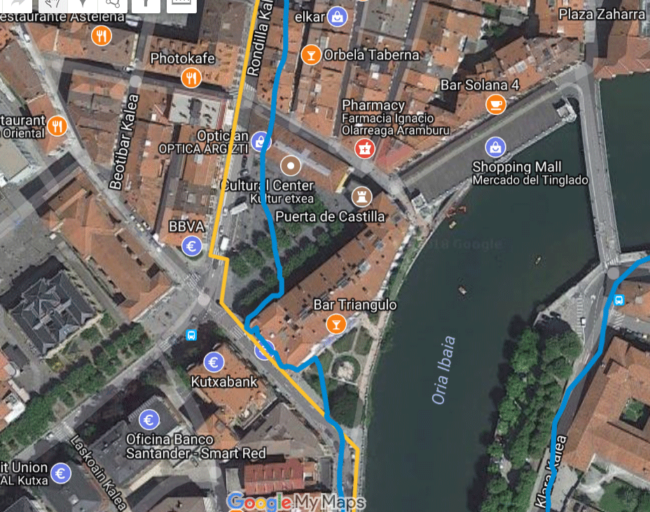

  • i've only done 4 runs so far (using gps+galileo) but i'm mighty impressed by the accuracy. however, on one of the runs i think i also experienced what you call spikes, see image
