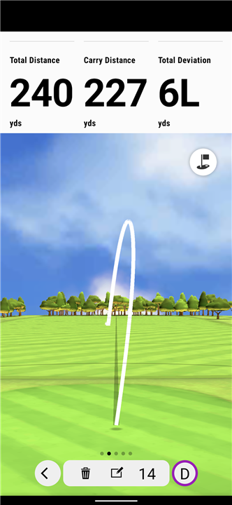

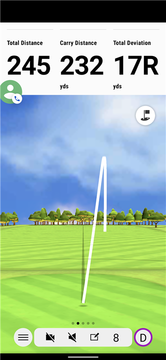

Something magical happened today and I am now getting very accurate results from my R10 when hitting into a net. I don't think I've changed anything so it's a total mystery.
Distance tee to net: 10'
Distance to tee: 7'
Unit tripod base approximately same height as mat
Garmin Golf app on iPad mini. Version 2.1.0.27
GCS Version: 3.9 (from App Diagnostics menu)
Approach version 3.60
For me, my distances were low by 1-2 clubs. If the distances displayed were in meters instead of yards, they would have been spot-on. If everybody was experiencing the same thing, I'd guess that they simply had a unit conversion error. However, since so many people have reported radically low distances, there's undoubtedly something else going on.
All that said, I just can't understand how, when nothing changed from day to day, the numbers could suddenly be accurate unless they sneaked a configuration file update or something that doesn't show up in the software or firmware version numbers.
