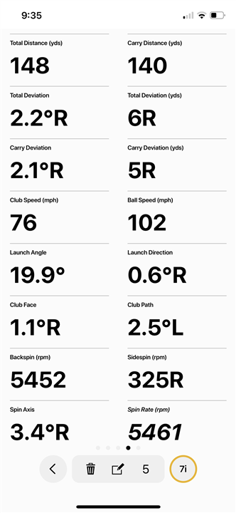

Varying the distance of the R10 to the hitting area may help… a user on the Facebook group said 1.75m (5.8’) was best for his setup. I’m estimating with two lengths of my 60deg wedge at the range and it seems fine… in general the unit seems to perform better outdoors.
The description of your setup sounds dead on, though you are at the outer distance of where they recommend putting the r10 behind the ball.
Post a photo of setup?

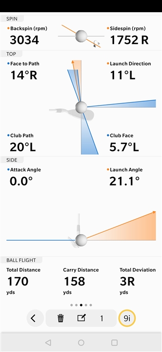

It seems my day at the range was just a one off for 3.6. The next day the device seems like it was back to not reading correctly. Giving me all types of AoA numbers on all clubs. 90% of the time I can rely on ball speed, club speed. I think the mat may have something to do with it. I used the same area I had with the good numbers after the new update, but completely different no matter what I tried. Ball flight is better than 3.3. My driver distances are better too. Before they were too long.
