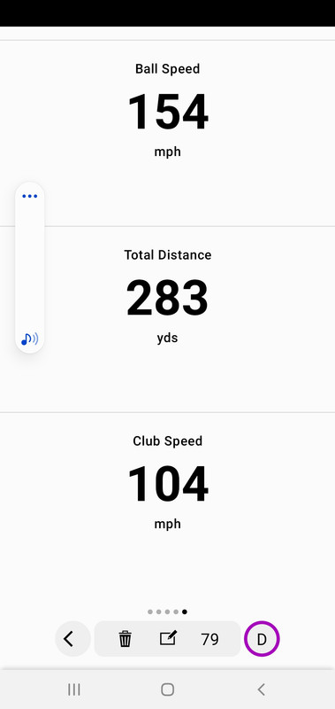

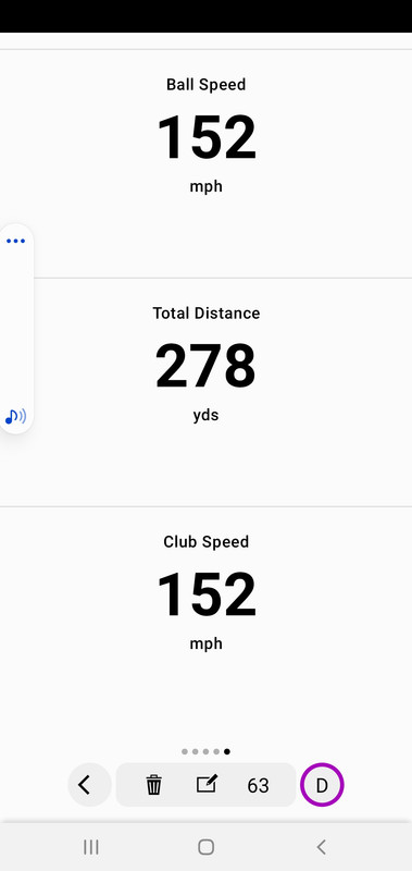

I tested the replacement unit and the distances remain unchanged. Below are 2 screen shots . Old unit running 3.3 and new unit running 3.4. No change in distances .

Thanks for the update. I don't see screen shots. Is this into a net? How far from ball to net?
