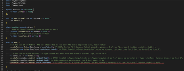

  • > In my case, Method actually does not fulfill the interface with invoke() I am using. And if I use Lang.Method() it (correctly) does trigger an error in the type-checker, and (incorrectly, but good for me) does not for Object.method().
    Well it depends on the type of function that was used to create the Method.
    In your case, new Lang.Method() can never fulfill the EvccTask interface because the compiler can't guarantee that the returned method has 0 args and returns nothing.
    But Object.method() can fulfill the interface, provided the symbol you pass in refers to a function that has 0 args and returns nothing
    Example:
