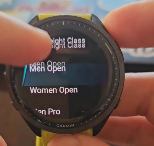

Hi Garmin Connect IQ Team,
Currently, there is no reliable way for an app to detect whether the device’s touchscreen is disabled (for example when the user has turned touch off in settings or enabled touch lock during an activity). The existing System.getDeviceSettings() properties like isTouchScreen and isTouchScreenActive only indicate hardware capability and not whether touch input is enabled or locked. As a result, even when the user has disabled touch, the app continues to receive and respond to touch events, which can lead to unintended interactions in sport/activity contexts.
This affects apps that rely on buttons and should respect the user’s preference or device lock during activities.
For example, for my app "Hyrox Smash", in a sweaty condition, it's quite risky to have the touch screen enabled.
If there’s already a recommended approach I’ve missed, I’d be happy to hear about it. Otherwise, I’d appreciate you considering this enhancement for future SDK versions.

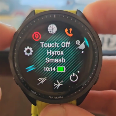

    According to the screenshot in the OP, the watch clearly shows that touch is currently off for their app.
    "Touch: Off
    Hyrox Smash"
    Any reasonable user would have the same interpretation. It is exactly analogous to the behaviour for touch settings on a per-activity basis. e.g. if you currently have the Run activity open, and you disable touch via the controls menu, the watch will display:
    "Touch: Off
    Run"
    And furthermore, touch will actually be disabled for the duration of the run activity. (Once you exit the run activity, then the "global" touch setting will apply.)

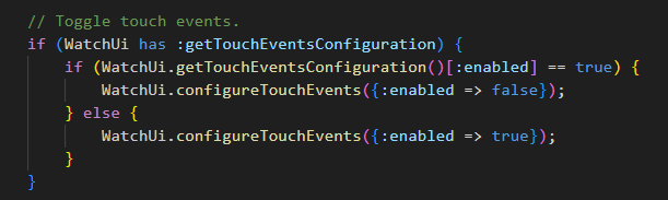

  • Please refer to the following API for how to check the current touch event configuration and how to set the touch event setting inside of a CIQ app.
    https://developer.garmin.com/connect-iq/api-docs/Toybox/WatchUi.html#getTouchEventsConfiguration-instance_function
    https://developer.garmin.com/connect-iq/api-docs/Toybox/WatchUi.html#configureTouchEvents-instance_function
    Here is some sample code to toggle touch events.
