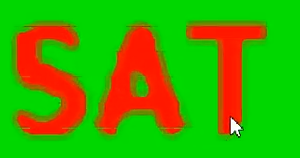

  • That's not what I see with mine.  I have a number of WFs that run fine for the v2 in the sim.
    If the WF has say a green background with white text, that's 100% of the pixels, and it works fine in low power mode.
