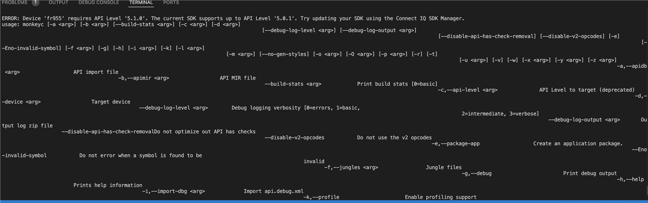

VS Code extension (Mac only): compiler usage / help information (-h) is garbled in the extension's terminal window

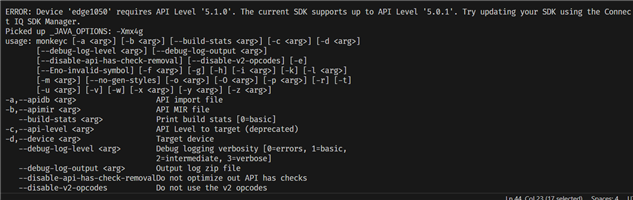

See comment for screenshot. (Looks like an issue with newlines)
