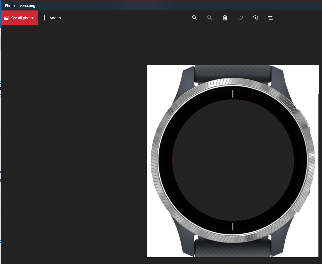

Problem with the simulator when simulating a 390x390 round device (Venu 1)
While simulating a 390x390 round device (Venu 1) in the simulator there's a weird circle with red and white colors over it for unknown reason. I've uploaded the problem to the connect iq forum here: https://forums.garmin.com/developer/connect-iq/f/discussion/275194/red-circle-drawn-around-390x390-round-devices-in-the-simulator and I believe after the discussion that it is a problem with the simulator (sadly, I don't have any Venu 1 devices to test it on a real device). Anyways, here's a picture of it https://ibb.co/4ZZcnqT (kinda hard to see, but still there, look at the edges).

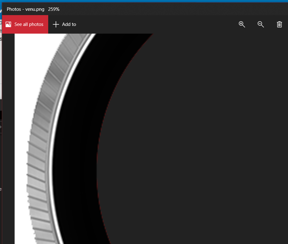

  • The problem appears to be with the Venu's device image in %appdata%\Garmin\ConnectIQ\Devices\venu\venu.png.
    The problem is subtle depending on what viewer you use to open it (due to the transparent pixels), but here it is in Windows 10 Photos, which changes transparent pixels to black:
    And here it is zoomed in:
