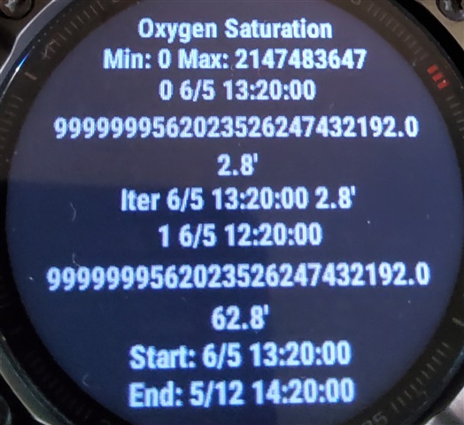

2. I don't when something change but now there is additional problem with getNewestSampleTime().value() from SpO2 sensor iterator
- on sim it is rather ok
- on device f6p 21.80 - returns rather not newest sample timestmap but timestamp of attempting reading value (I can't see the same value like in widget but usually can see value very close to now())

  • samples in sensor SpO2 history after conversion (Sample0.data ? Sample0.data.toFloat().format("%.1f") : "---") now looks like
    9999999999999999893774739473192.0
    iterator.getMin()  =>  0
    iterator.getMax()  => 2147483647
    I've check others SDK to 3.25 an the same effect so it has to be problem with new firmware but how to report it?
