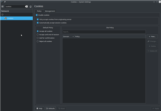

    As far as I can tell system level cookies are enabled - however none are being stored by the garmin tools:
    I can see that both the SDK manager and simulator store information in the `.Garmin` folder of my home directory but there's nothing in there related to login details.
  • Check your machine's settings for cookies.  It kind of sounds like you aren't saving the cookies you need.
