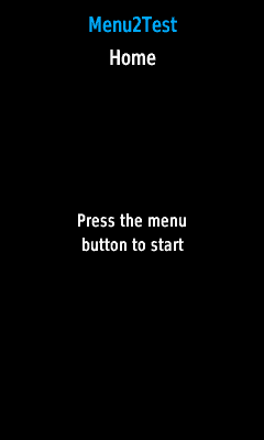

Running the Menu2 e.g. from the example within the SIMULATOR leads to missing screen refresh on the GPSmap device (missing simulator support for gpsmap?).
Is this running on the real hardware with latest firmware and Connect IQ 3.0 support?
Edge 830:
GPSmap 66:
  • I don't have hardware to verify, but this should be working there.
    The problem is that there is no <menu2/> element in devices.xml to tell the simulator how to display the menu. If you copy/paste the data from a device with a similar display size (like the edge1030) the simulator will display a menu but it won't work because the menu type (scrollable) only works with devices that have a touch screen.
