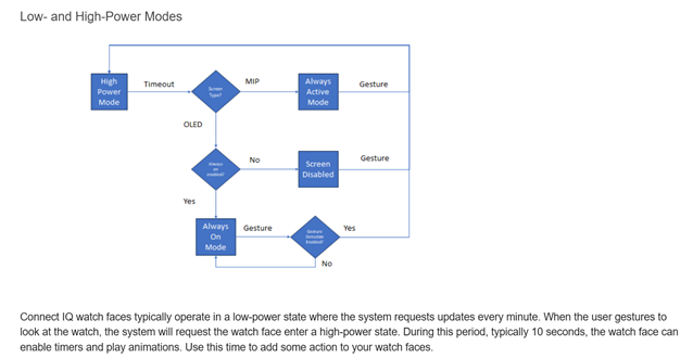

  • I do think there's room for clarification in the docs and UI.
    For example, the diagram and accompanying text I pasted from the docs (in the Low- and High-Power Modes section) implies but does not outright state that low power mode is synonymous with Always Active Mode / Always On Mode in the diagram. The diagram and text could use some clarification to make the connection explicit.

    As far as the name goes, according to the CIQ watch faces documentation, "Always Active Mode" is basically synonymous with Low Power Mode for MIP devices. I realize that you're thinking of "Always Active" as the feature which allows the watch to stay in low power mode indefinitely (as opposed to very old MIP devices, for example, which could not do this.) But Garmin is obviously using "Always Active Mode" a bit differently in this context.
    I think the reason they renamed it is because they want to distinguish between MIP low power mode ("always active") and AMOLED low power mode ("always on"), since the behavior from the end user's POV is different (as there are different rules regarding what the screen can display in the two low power modes.)
