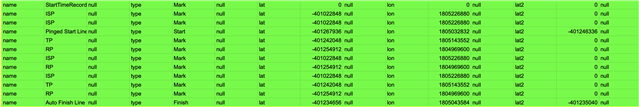

To demonstrate the issue, I have processed a correct (A3ID5501.FIT) and an incorrect (A3JH5003.FIT) FIT file through FitCSVTool and pasted the output into the linked spreadsheet and extracted just the "lap" messages.
Both files were generated on the same watch with the same app code, although running in any number of different modes, 24 hours apart.

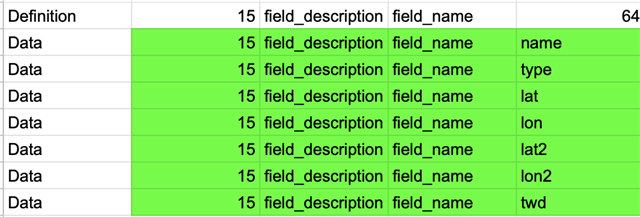

The first A3ID5501.FIT,  shows the seven field definition messages
and the lap records containing the seven defined fields with valid data:
The second, A3JH5003.FIT, contains no field definition records and fields 37 to 42 corresponding to my user defined fields  containing corrupt data:
Note the unusual pipe-delimited format of the value fields.
