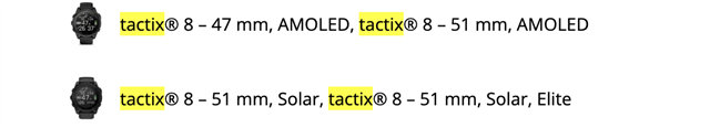

  • Based on everything I said above, I would expect apps which *actually* support Tactix 8 models (meaning they support part numbers B4775 and/or B4776) to have *double* entries in the supported devices tab:
    - one for each of the real Tactix 8 part numbers (with text like "Tactix 8...")
    - one for each of the base Fenix 8 part numbers (with text like "Fenix 8.../ Quatix 8..../ Tactix 8...")
    And as a matter of fact, this is true for the popular Crystal watchface.
    I'm sure it would be true for any app that was built recently, which targets the fenix847mm and fenix8solar51mm Connect IQ devices
    https://apps.garmin.com/apps/9fd04d09-8c80-4c81-9257-17cfa0f0081b
    Obviously the 1st and 3rd entries below are for B4536/B4533
    Obviously these are the entries for B4775/B4776
