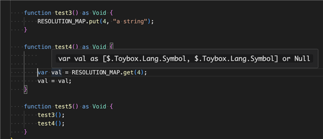

  • maybe it suggests that the compiler should *never* be inferring the original value type for a get of any key for a dictionary?
    Except in the case that the get() happens "immediately" after the put() (i.e. in such a way that the value type could not have changed in between. (i.e. no intervening function calls)
    Anyway, I appreciate that the compiler is trying to be helpful, but I think it goes too far in some cases in inferring a specific value type (or Null) when Object or Null would be more correct. I do understand there's probably a balance between strict correctness and trying to make the type system as useful as possible.

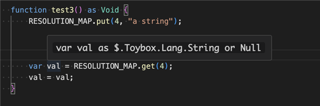

  • I noticed that the compiler tries to be smart here.
    e.g. If I change/add a key with a different value type in a function, then get the same key immediately afterwards in the same function, the compiler will infer the new value type or null.
    While this is nice, since it's actually trying to be smart, why not infer the new value type and not null?
    But of course, if I move the access of key 4 to a different function, the compiler infers the *original* value type.
    While it's obvious why this is happening, maybe it suggests that the compiler should *never* be inferring the original value type for a get of any key for a dictionary?
    It looks like the compiler is:
    - trying to be too smart in some cases: inferring VALUE_TYPE or Null for an arbitrary get() when it should be Object or Null
    - not being smart enough in some cases: inferring VALUE_TYPE or Null for a get() that follows a known put() when it should be VALUE_TYPE. (At least be consistent and infer Object or Null.)
