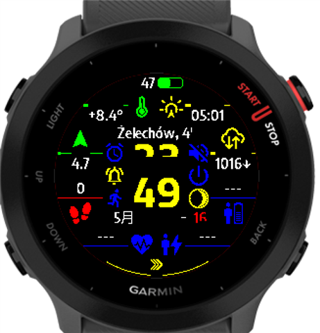

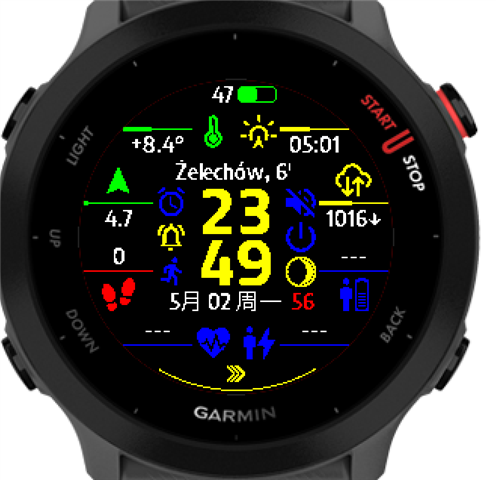

  • no, I need clip in onUpdate:
    with clip
    without

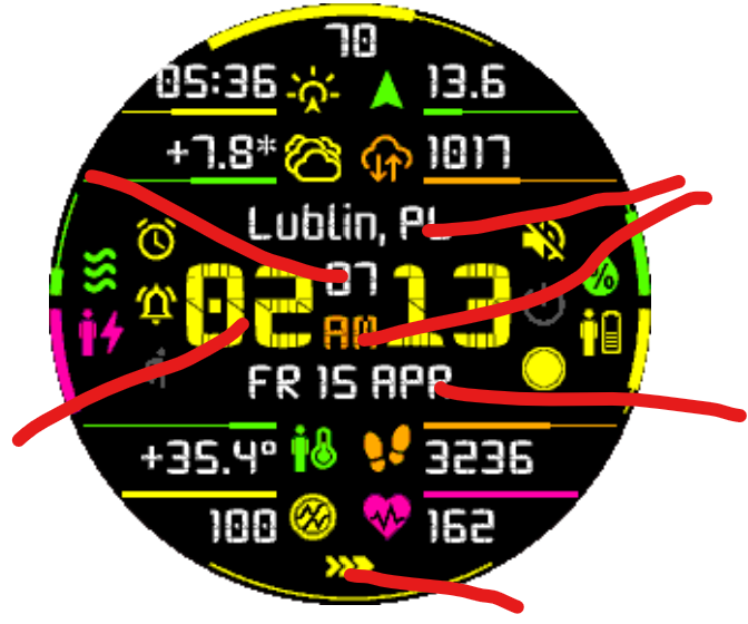

  • You are wrong
    - name of town can be longer than width of filed - I have to calculate length of string, shorten it or simple clip
    - drawing hours/minutes/seconds/ am/pm - overleaped others regions
    - bottom icon without clip overlaps progress and upper icons
    - all numbers overleaps progresses
    try to draw this pictures without clips
    I need a lot of data not only time and steps so have to use each pixels
