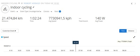

But that doesn't work. I'm still getting location data, and the distance and speed data all over the place: getting 1000000km of distance in no time.

Besides, I would assume, if GPS is disabled, Edge would collect the distance and speed information from my bike trainer (paired with ANT+ FE-C protocol). But that doesn't work neither. It's not working on 530/830/1030 neither. I can see the correct data, if I check the Edge's default datafields (not in-app).
