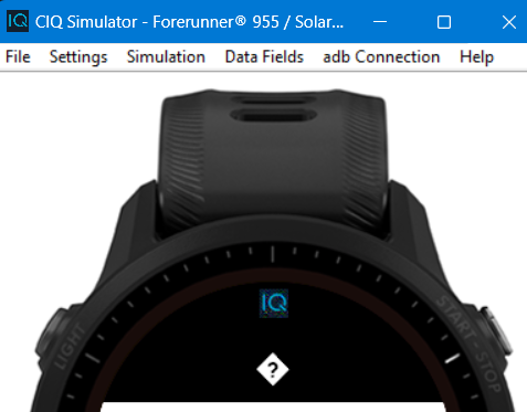

  • I see a similar problem in Windows, except instead of displaying a random string literal from the app, the toast displays the "question-mark-in-diamond" character which is displayed when a given character isn't available in the current font. As far as I know, I don't have any strings in my app that consist of a single special character (e.g. non-ASCII).
    The problem follows the same pattern in Windows as it does in Mac:
    - passing a string variable as the first arg to showToast() works
    - passing a string literal, literal resource ID or resource ID variable to showToast() fails
  • > - compiler sees "toast" string literal in multiple places and puts 1 string constant to the data and uses a reference to it in all places.
    While it's possible that the compiler folds duplicate string literals as you described, I don't think that has anything to do with the problem. I tested differently from you:
    - I tested with a string literal that is different from any other string literal in the app, and the problem occurs
    - I tested with a literal resource ID, and the problem occurs
    - I tested with a resource ID variable, and the problem occurs
    The only way I was able to make it work correctly in the simulator was to use a string variable.
