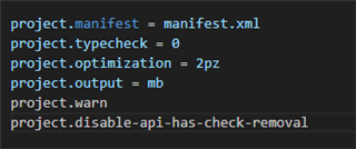

  • Hi Jim. The first 3 lines work fine. If I try to add any of the next three, I get errors. Seems I can set these compile options in monkey.jungle?

  • Same for optimization in monkey.jungle.  This gives far more control on a project by project basis..
  • This is how it works and was designed to work.  The project.typecheck=x in the monkey.jungle is only used if the typecheck level in the VS C extension is set to "default".  There is no -l specified on the compiler command line, but it does use type checking ("gradual" it appears) - that's the "default" with the current SDKs.  If you specify something other than default, you see a -l on the command line
