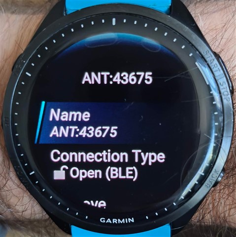

bug: natively paired ANT+ sensor's Connection Type is displayed as Open (BLE)
I'd like to report this here, because it is related to CIQ, though I think it should probably be reported to the firmware teams as well (but unfortunately there's no way a user can report it via customer support, as at the moment they hear CIQ they drop the line and enter into deep hibernation state...)
1. bug: after I pair an ANT+ heart rate sensor from fr965's system sensor menu (choosing the "IQ" line) I see it's paired, but the Connection Type is misleading: Open (BLE). This can't be true for 2 reasons: 1. the same device is already paired via BT to the watch (not to a CIQ app), and I only removed the ANT pairing before I performed this test, 2. because my CIQ datafield ( https://apps.garmin.com/apps/7c83d402-4b68-4f0a-b167-7139788a19b3 ) doesn't have any bluetooth related code, only ANT+
this happens on fr965 27.09, fr255 27.09
